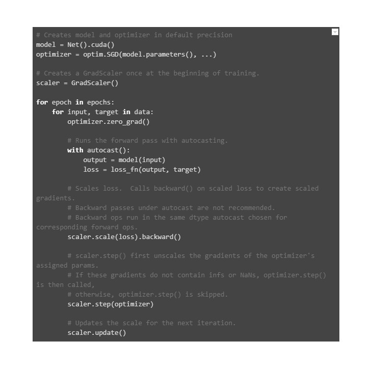

After version 1.5, pytorch started to support automatic mixed precision training. The framework can identify modules that require full precision and use 32-bit floating for them and use 16-bit floating for others. Below is a sample code from the official Pytorch documentation.

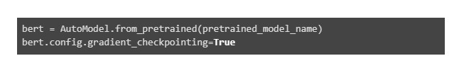

The last not least tip is to use gradient checkpointing. The basic idea of gradient checkpointing is only to save intermediate results of some nodes as checkpoints and re-compute other parts in between those nodes during backpropagation. According to the authors of gradient-checkpointing, with the help of gradient checkpointing, they can fit 10X large models onto their GPUs at only a 20% increase at computation time. This is officially supported by Pytorch since version 0.4.0, and some very commonly used libraries such as Huggingface Transformers also support this feature.
Below is an example of how to turn on gradient checkpointing with a transformer model:

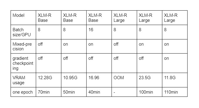

At the end of this post, I want to share a simple benchmark test I made on the HP Z4 workstation. As I mentioned before, the workstation is equipped with 2 24G VRAM RTX6000 GPUs, while in the experiments I only used one GPU. I trained XLM-Roberta Base/Large with different configurations, and the training set of the Kaggle Jigsaw Multilingual Toxic Comment Classification competition was used.
As we can see, mixed-precision training not only reduces the memory consumption, but also provides a significant speedup. The gradient checkpointing is also very powerful. It reduces the VRAM usage from 23.5G to 11.8G! I wish I could know this technology earlier so that I can even train the XLM-Roberta Large model with my previous 11G 2080Ti GPU :)
