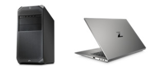

Z8G4 powered with 2x RTX 6000    ZBook Studio powered with RTX 5000
I am working on a CV competition with the above powerful systems. Compared to the time when I used V100, I now have systems that can run freely at any time and have a higher speed, so the number of experiments that I can run has increased greatly compared to before, and I can also run comparative tests of various papers.

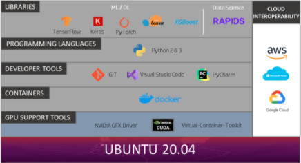

Environments such as pytorch PyTorch and cuda CUDA are pre-installed in the systems, so there was no need for me to build the environment.

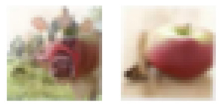

I would like to compare two images of CIFAR-100 by mixing them. Some of the figures are cited from papers.

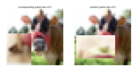

## CutMix
[paper with code](https://paperswithcode.com/paper/cutmix-regularization-strategy-to-train)
A technique in which one image is cut out with a bbox of a certain size and pasted into the other image.
There are two methods: corresponding paste which pastes at the same position as the cut-out position, and random paste which pastes at random positions.

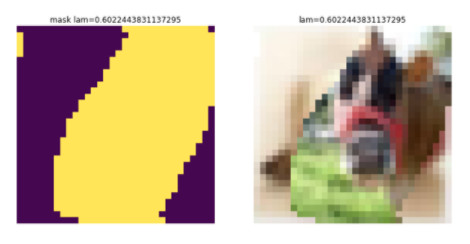

 ## fmix
[paper with code](https://paperswithcode.com/paper/understanding-and-enhancing-mixed-sample-data)
 Compared to CutMix, a mask can be generated and mixed regardless of shapes (does not have to be square shaped).

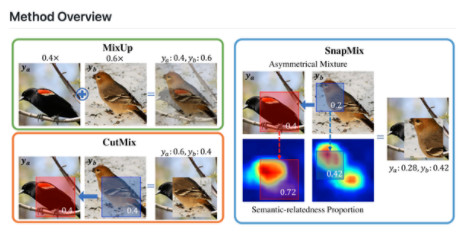

## SnapMix
[paper with code](https://paperswithcode.com/paper/snapmix-semantically-proportional-mixing-for)
Reduce background image noise by using CAM to weight the label after mixing. Figure is cited from the paper.

As noted in ResizeMix's paper, random paste was more accurate for Cutmix. ResizeMix, on the other hand, was less accurate than Cutmix, which is a different result from the paper.
